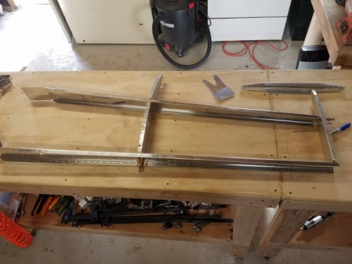

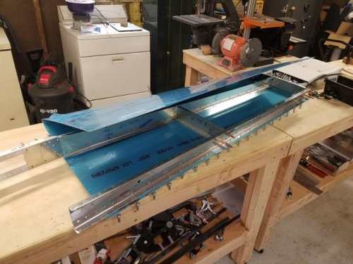

Match drilled left side HS-00005 to spar. Match drilled all holes in the left side HS-801PP skin. Removed skin and drilled remaining holes in HS-814-1, HS-810-1 and HS-00003.

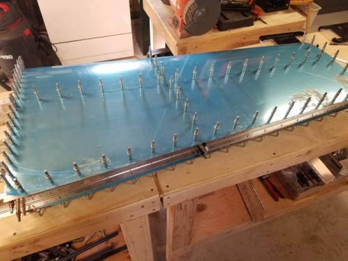

Clecoed the right side HS-702, HS-603PP, HS-706, HS-707 and HS-708. Drilled all rib to spar attach holes to #30 except 603PP to HS-708. Deburred all holes. Clecoed on HS-801PP skin for right side. Enlarged HS-708 to HS-603PP holes to #21. Misdrilled top hole to #12. Contacted Van’s and ordered new HS-708 rib due to the amount of material removed from the flange with the #12 drill bit. Drilled and clecoed aft flange of HS-00005 rib to 603PP spar. Match drilled aft flange of HS-00006 to HS-702 and HS-00003. Match drilled all HS-00005 holes in forward flange. Match drilled holes from HS-801PP skin to HS-00005 and HS-00006. Match drilled remaining HS-801PP holes. Completed all drilling for right side of horizontal stabilizer.
Marked and disassembled all parts.
