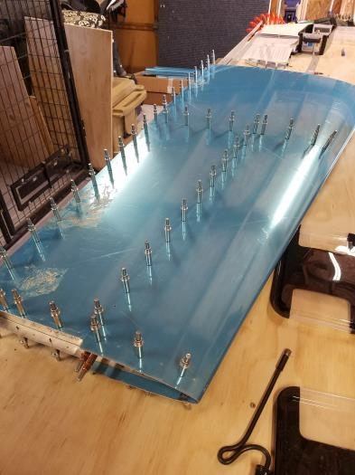

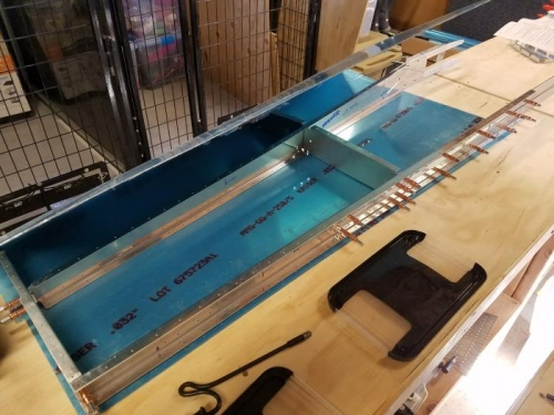

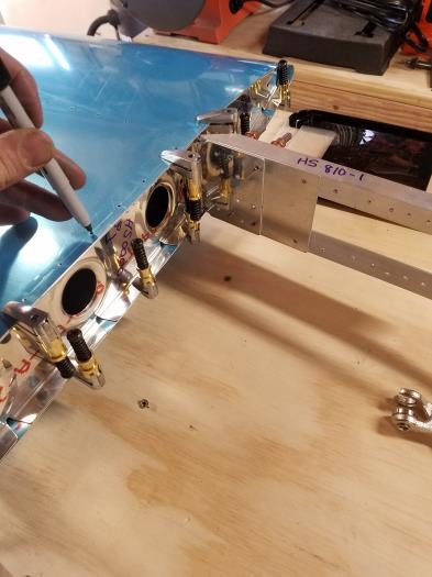

Brief Description:  Left side horizontal stabilizer assembly
Drilled and deburred rib to spar attach holes. Clecoed HS-801PP skin and assembly together. Enlarged HS-708 holes. Marked HS-00005 and HS-00006 holes with reference to skin. Match drilled HS-00005 to rear spar. Match drilled aft flange of HS-00006 to HS-702 and HS-00003. Match drilled #40 holes through HS-00003, HS-702, HS-801-1 and HS-814-1.
