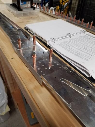

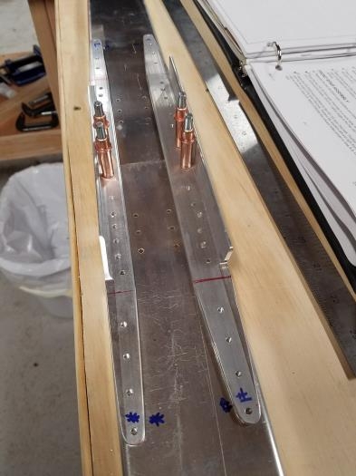

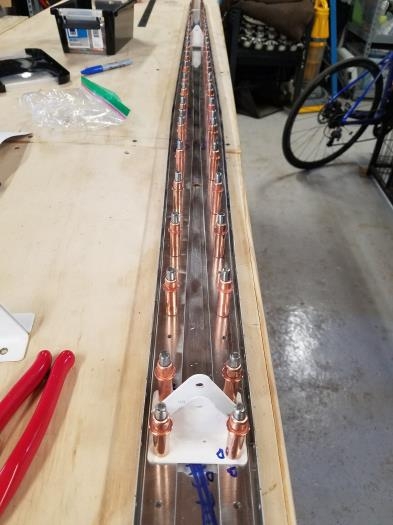

Brief Description:  Completed Rear Spar Assembly & Front Spar Assembly
Verified remaining steps of Rear Spar Assembly section completed by previous builder. Ran #30 drill through HS-603PP/HS-609PP prepunched holes to ensure they were final drilled. HS-411P bracket is assembled. Marked all parts to retain orientation.
HS-00003 doublers have been separated and holes verified to be drilled correctly. First five steps of Front Spar Assembly section have been correctly completed by previous builder.
Made 6 degree bends in HS-810-1 and HS-814-1. Drilled, marked and bent tabs on HS-702 x 2. Notched ribs HS-00006. Verified flanges on HS-00005 and HS-00006 are square and adjusted some with hand seamer. Began edge finishing on HS-00005 and HS-00006.
