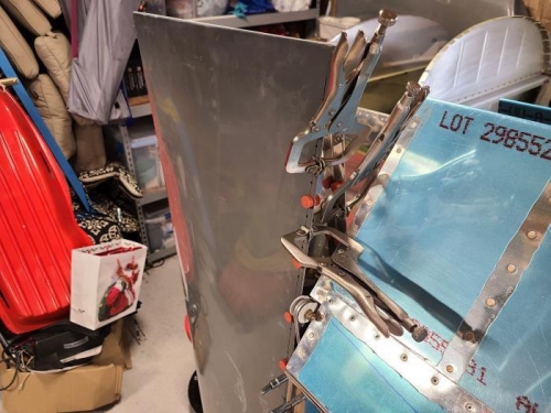

Date:  3-23-2020
Number of Hours:  2.30
Manual Reference:  7-12
Brief Description:  Wingtip
Today I continued working on the left wingtip. I temporarily put the wingtip rib in and then marked where it would go. I then removed the wingtip and laid out the rivet lines as called out in the instructions. Finally, I used magnets to hold the rib in place and clecoed the tip back on the wing. I then used clamps to make sure the rib didn't move and drilled the rivet holes.
