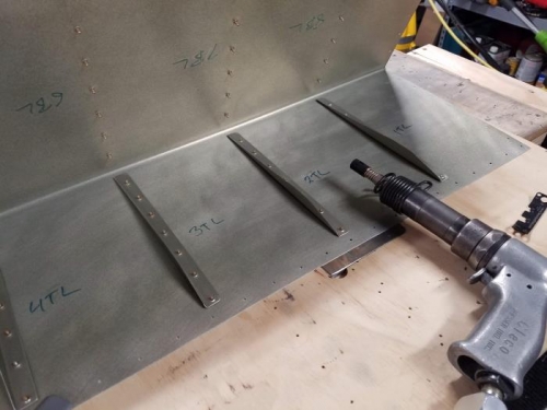

Then I moved on to the ailerons. The first thing I did was back rivet the stiffeners on to the aileron skins. I then used my 2x8 brake to partially bend the skins. As with the rudder I had to finish the bend with my hand seamer. It came out good. I'm happy with both skins and they both match the plans.

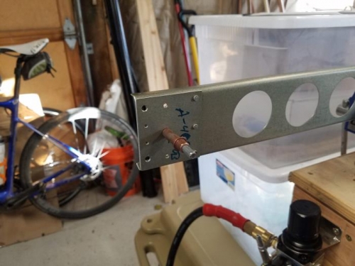

After that I riveted the A-408 reinforcement brackets to the aileron spars. I also riveted on the K1000-3 platenut to each spar assembly.
