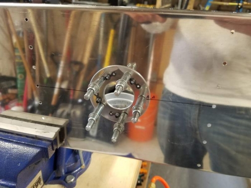

The first thing I did today was rivet on the reinforcing ring to the left tank baffle for the fuel sender gauge in the 2nd bay. I had to do this because I'm putting a flop tube in the left tank. I dimpled the baffle and countersunk the ring to accept the dimples. Then riveted it on.

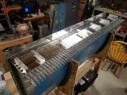

The rest of the day was spent sealing the right tank. The first thing I did was seal and torque the fittings for the vent tube. Then I moved on to sealing the baffle. I mixed up a bunch of sealant and filled two syringes. I put a bead of sealant down both sides of the tank right below the baffle rivet holes. I also smeared sealant over the rivet holes on each rib and ran a bead of sealant down each end rib. I dropped the baffle down and clecoed it 100%.
I moved on to riveting the pop rivets in to the ribs and then pop riveted the middle Z brackets on. I moved on to the end Z brackets and used the rivet gun to rivet those on, followed by the rivets on the back of the end ribs.
