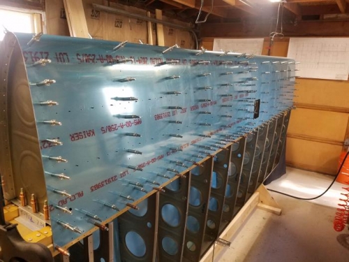

Brief Description:  Fitting Tank Skins and Z Brackets
Today I finished fitting the tank skins and Z brackets. Well, almost. I still had one of the inboard Z brackets that did not come out right even with the Hurlbut method. I ordered more brackets from Vans and hopefully third time will be the charm. All the rest of the brackets came out perfect and the skin fit perfectly with the leading edge.
I also drilled the screw holes between the T-701 skin and the W-423 joint plate.
