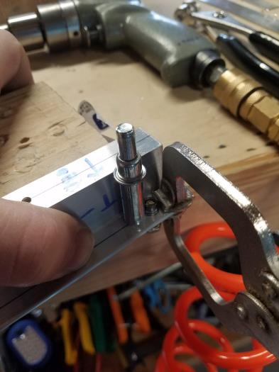

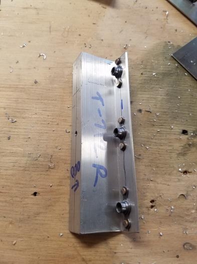

Brief Description:  Fitting the Attach Angles
I worked on the Z bracket attach angles today. I removed the angles from the spar and drilled all the platenut holes using a platenut and bolt as a guide. I then countersunk all the holes for the flush rivets and then used a pneumatic squeezer to rivet the platenuts to the angles. I then bolted all the angles to the main spar and started looking at how to fit the inboard Z brackets. I'm going to have to do some more research on those because they don't look like they are going to line up.
