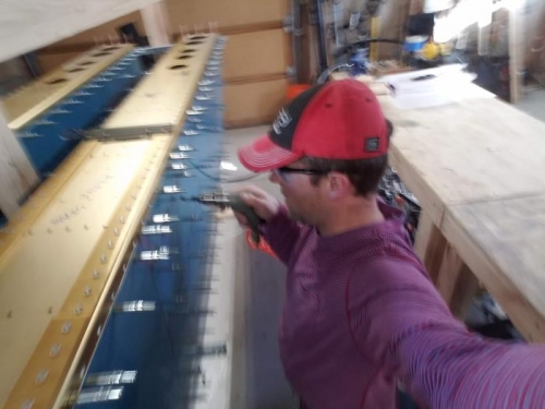

Date:  12-16-2018
Number of Hours:  4.30
Manual Reference:  7-4
Brief Description:  Drilling the Main Wing Skins
I got a lot accomplished today. I match drilled all the holes in the main skins and the wing skeleton. I also drilled and dimpled the wing inspection cover plates and extended the lines on the wing skins on to the cover plate on each wing that lines up with the tiedown hole. Hopefully this makes it easier to locate the hole on the leading edges.
