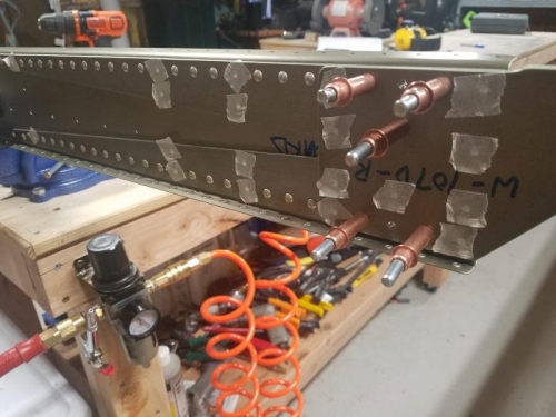

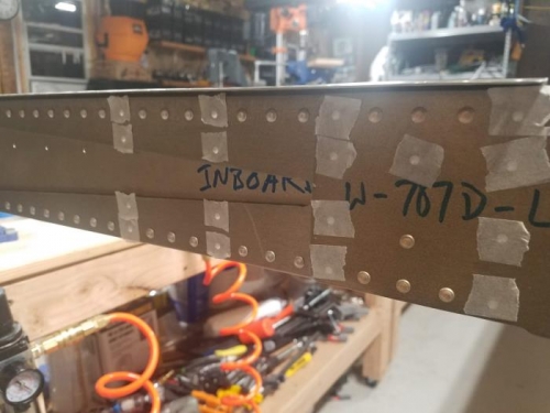

Brief Description:  Priming and Assembling the Rear Spar
I spent two hours priming the rear spars and the spar reinforcement pieces.
Later I went back and clecoed the W-707-D, -E, -F and -G reinforcement plates to the spars. I put masking tape over all of the rivet holes that hold other things on and then riveted the reinforcement plates to the rear spars.
