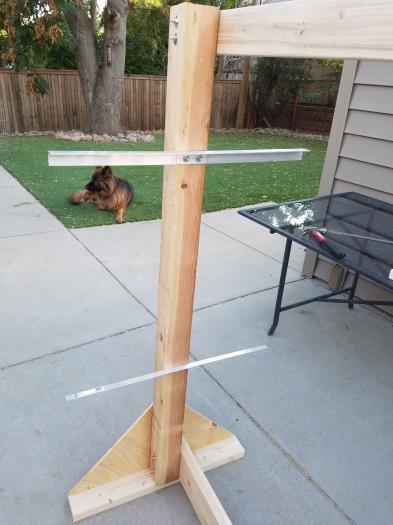

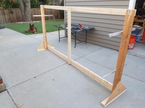

Brief Description:  Building Wing Stand
Today I mostly finished construction of the wing stand. I put the last six bolts in the main structure. Then I drilled and mounted pieces of aluminum angle for supports for the main and aft spars. I also fabricated and mounted a support for the center post that will allow me to take the sag out of the middle of the wings.
The posts are 60 inches tall and so is the 2x4 in the middle. The 2x4 on top is 120 inches long and so is the 2x6 on the bottom. The faces of the posts are 114 inches apart as per the plans on DWG 12A. The feet for the stand are 2x4 pieces 27.5 inches long with a 19 inch square piece of 1/2 inch plywood cut in half as the stiffener on each side. The top aluminum angle is 1/8 inch angle and are each 27.5 inches long. The bottom angle is 1/16 inch angle and each piece is also 27.5 inches long.
