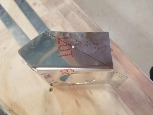

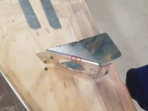

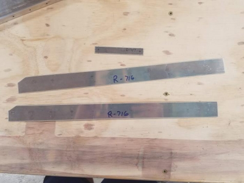

Today I prepped the rudder skeleton for assembly. I started by clecoing the R-606PP, -607PP and -608PP reinforcement plates to R-802PP spar. I then used the band saw to fabricate the R-717 spacer and both R-716 bottom attach strips. I trimmed the R-710 as described in the plans. Then I cleaned up all the edges of all of the pieces. I enlarged the middle hole in the R-704 rib flange to ⅜ with the unibit for the red end. I clecoed the remaining pieces of the skeleton together.
I clecoed the R-703 to the R-802PP and then drilled the holes to #30. Then I removed the R-703.
I fluted the forward flange of the R-703 so that the holes in the R-713 lined up with it. Then I clecoed the two pieces together and drilled all the holes common to the two pieces to #40.

I clecoed on the R-801PP skin, R-703 and R-713 to the understructure. With the -801PP skin clecoed to R-704 and R-802PP I drilled the holes in the R-710 using the R-801PP holes as a guide. I then clamped on the R-716 pieces and match drilled the holes from the R-801PP. It all went without a hitch!
