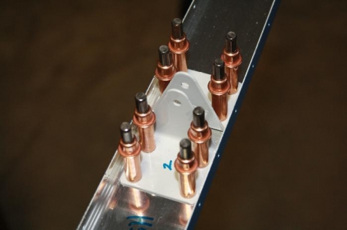

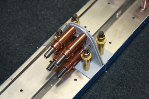

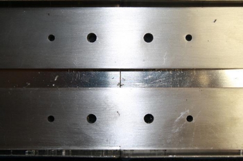

Final drilled all elevator hinge brackets. Attached HS-411BP brackets to VA-146 bearing and match drilled all attach holes. Drilled/enlarged the HS-411 assembly to spar bolt holes to #12. Deburred numerous holes. Awaiting delivery of #21 drills to enlarge the HS-708 main rib to rear spar assembly holes.
Elevator Hinge Brackets
HS-411 Brackets & VA-146 Bearing
HS-411 Assembly to Spar #12 Bolt Holes
