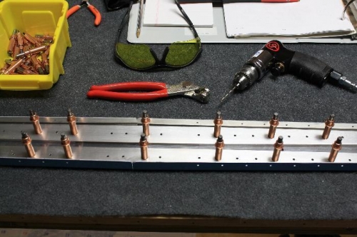

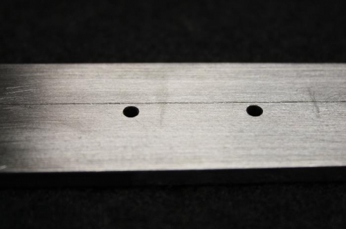

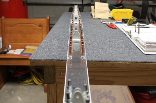

Smoothed the edges and surfaces of the rear spar reinforcement bars to a satin finish equivalent to that left by 400 grit wet/dry sandpaper. Both reinforcement bars required extra sanding to remove deep marks. Clecod the reinforcement bars to the spar channels and final drilled all holes to #30. Oddly, my RV tool kit had #19 drills, not #21. Since the plans set calls for #21, I'll need to procure #21 drills so I can final drill the holes where the main ribs attach to the rear spar assembly.

More sanding required
Ready to final drill
Final drilled holes to #30
