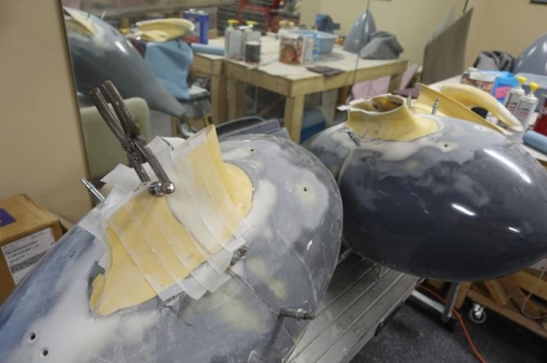

Sanded the upper and lower main intersection fairings. Added a layer of 6oz cloth to the top and bottom seams in order to provide a better defined transition.

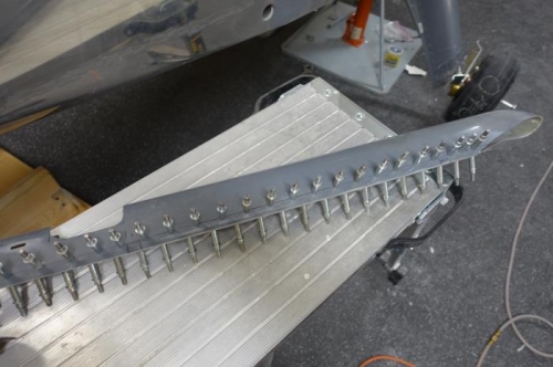

Fit and drilled the connecting piano hinge to the nose gear fairing.
