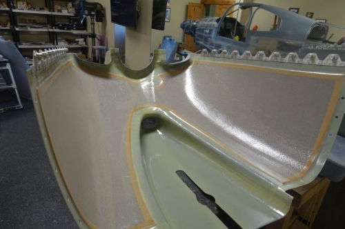

Brief Description:  Cowl
After the intial inside and outside sanding of both cowl pieces, I applied a thinned coat of resin to the inside of the bottom cowl. This will provide a good base for a prime and top coat. The top coat will allow for easier cleaning. I then began installation of the upper intake scoop ramps. The majority of today's time was taken up by trimming the left ramp around the prop governor. I'll epoxy the ramps in place tomorrow.
