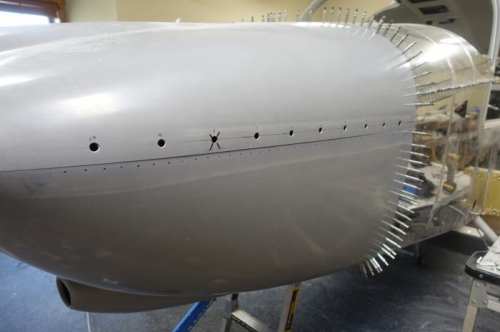

Brief Description:  Cowl

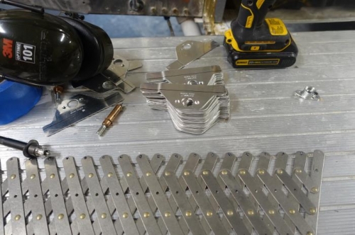

Began installation of the Skybolt fasteners. Laid out the fastener pattern on the horizontal seam between the top and bottom cowl after locating the common aligned left and right firewall fastener. Cleaned and deburred the 60 fastener brackets. Drilled the horizontal fasteners to the bottom cowl and drilled out the receptacle holes on the top cowl.
