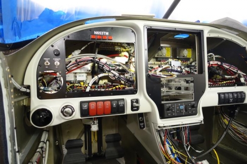

Focused on finishing up the left side of the panel. Finished wiring the starter switch, oil cooler door, alternate static, flap switch, etc. Ran the pitot, AOA and static lines. Tied up all the wires and bundles on the left side of the panel.
