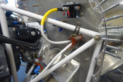

Date:  9-2-2020
Number of Hours:  1.10
Brief Description:  Fabricate Grounding Cable
I fabricated most of the engine grounding cable. The #2 cable will run from the engine block throught the firewall and attach to the grounding forest of tabs located on the sub instrument panel. The cable attach point is on the front side of the panel so it was much easier to make that attachement prior to riveting the forward fuse in place.
