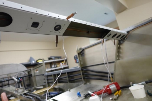

Date:  6-28-2020
Number of Hours:  5.00
Brief Description:  Install O2 Fill Line
Mounted the O2 filler port and the associated copper high pressure fill line. The filler is located just forward of the baggage bulkhead. The line runs through the back seat brace and back along the right fuselage side through the baggage bulhead where the O2 bottle will be located.
The line is visible in the rear seat brace
