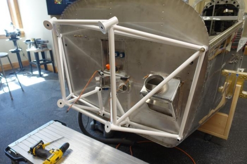

Brief Description:  Install Engine Mount
It took nearly seven months to get the engine mount but only a day to get it mounted. This is my third RV engine mount and by far the most accurate. I stepped drilled each of the six mounting holes and used a 3/8" ream to finish up each hole. No issue and the process went very smoothly. After all the drilling, I removed the mount in order to attach the oil cooler mount and sensor manifold.
