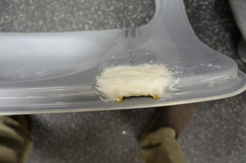

Pulled the four door hinges from the flox/Cabo fill. Lot's of snading to level off the fill. I'll fill further to get a good surface and will finish off with a couple layers of glass cloth.

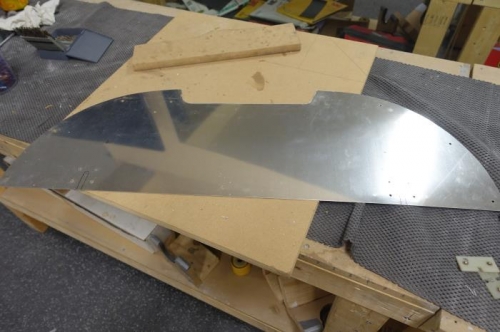

Most of the work today was focused on cutting the new upper baggage bulkhead. The overall shape was completed and I match drilled the mounting holes.
Slot for door hinge.  Lots more work.
