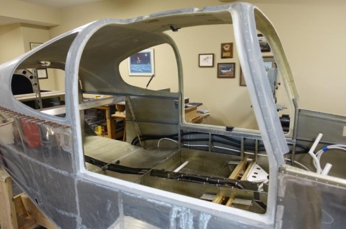

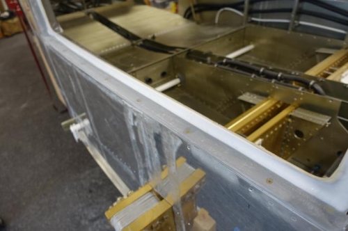

Date:  4-23-2020
Number of Hours:  2.10
Brief Description:  Install Doors
I removed the right door and 1/4" weather stripping used to establish the seal gap on the lower portion of the cabin door opening. I further trimmed/sanded the inside of the lower door opening to ensure a 1/4" flange for the door seal. Lastly, I applied a skim coat of micro along the entire perimeter of the cabin door opening.
