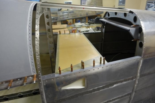

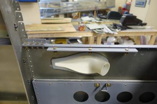

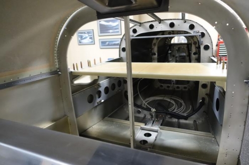

I fit the fiberglass air conditioning equipment tray behind the baggage bulkhead. After trimming the tray to fit between the upper longerons, I attached the two tray hold down brackets to the upper longeron and match drilled mounting holes for the tray. Afterwards, I cleaned, deburred, primed and riveted the brackets to the upper longerons. I also mixed a bit of slurry to cleaned up some very minor imprerfections on the fiberglass tray.
