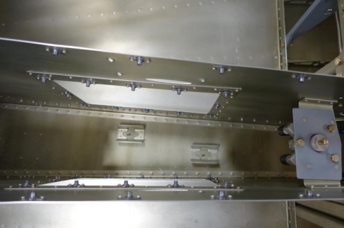

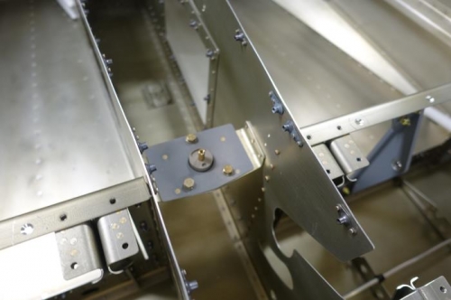

I partially fabricated the right tunnel brake line. I've ordered a parking brake but it hasn't arrived yet. So in the meantime, off to the next chapter.
I mounted the Andair fuel valve which required a modified mounting plate. I also began looking at mounting the fuel pump and filter. It seems there is a new style pump which requires a filter mounting point aft of my kit's location. I'm not sure when this change occurred but my bottom skin is not up to date and as a result, I get to remove the existing filter mounting bracket and mount a new one. Not a major issue but access the bottom of the forward fuselage is a bit difficult right now. I'm getting some additional help this Friday, so the new mount will go on then.
The mount on the right is too far forward.  The new mount slightly overlaps the existing one...or will
