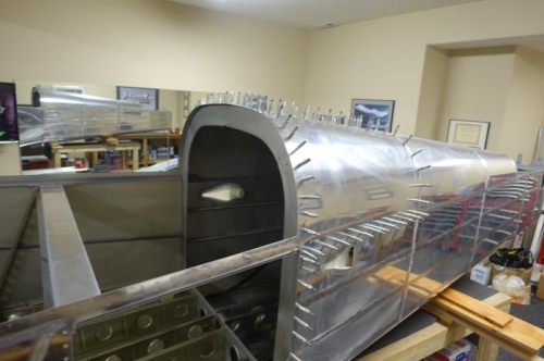

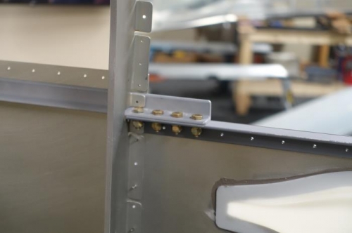

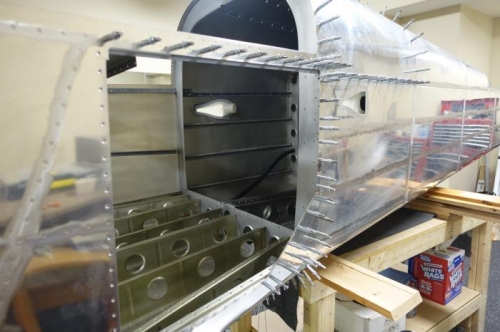

Date:  9-28-2019
Manual Reference:  32-3 & 4
Brief Description:  Attach Tail Cone
Drilled the eight longeron bolts that attach the mid fuse to the tail cone and bolted in place. Final drilled the numerous rivet holes along the baggage bulkhead, the top longerons, around the baggage door opening and the lap joint on the bottom skins.
