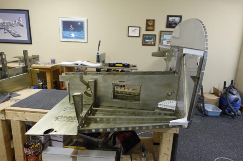

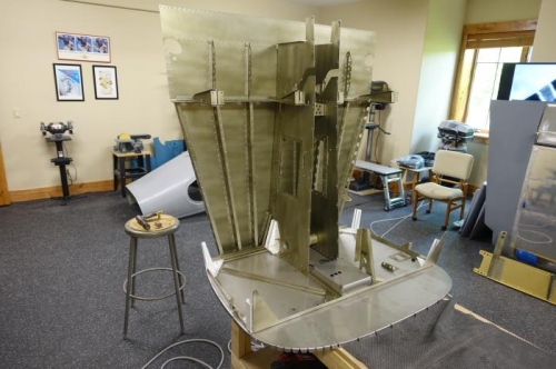

Riveted the firewall to the bottom skin. Applied a coat of proseal on the firewall flange. Riveted the two forward fuselage ribs to the bottom skin. Riveted the rib attach angles and forward floor rib tabs. Bolted the forward section bulkhead assembly to the forward fuselage ribs.
