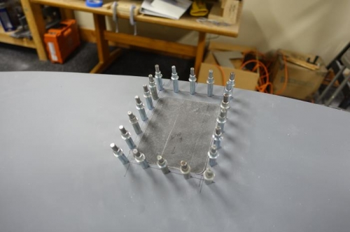

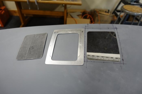

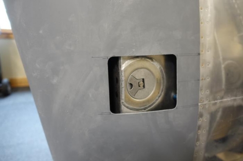

Trimmed the ER tank access doors. Fabricated, fit and drilled on the door attachment flange to each wingtip. I orded some Skybolt fasteners yesterday that I'll use to hold down the doors. Instead of a hinge, I'll use an aluminum tab on the inboard end of the door. That will make the door fully removable but will also avoid the ugly piano hinge. I considered a hidden hinge but there really isn't sufficient room due to the close location of the ER tank.
Verified the opening minus the aluminum attachment flange
Door, flange and access hole
Flange drilled and door test fit
