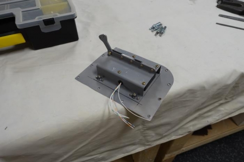

Assembled the electric aileron trim mechanism, attached to left inboard wing bottom access door and installed the spring attach brackets to the push pull tube.

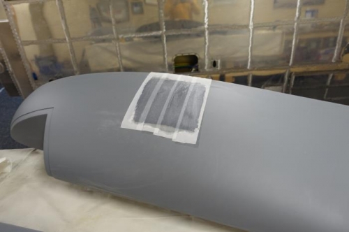

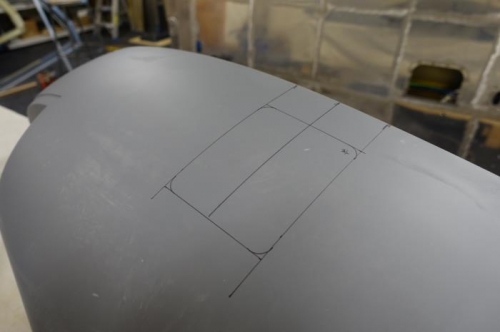

Measured the location of the extended range tank access doors on both wingtips. I'm going to fabricate new doors using a sandwich layup of two layer of fiberglass cloth and two layers of carbon fiber.
Electric aileron trim mechanism attached to access door
Location of ER tank doors
Layup of cloth and carbon
