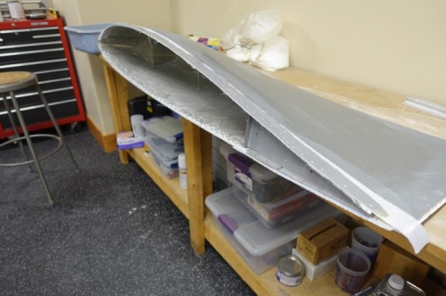

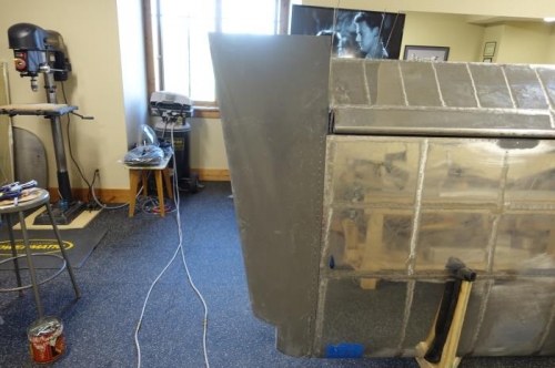

Primed and riveted the right wingiip rib. Wet sanded the various micro used to clean up after the wingtip surgery. Put down a layer of 3/4Oz fiberglass cloth over the right wingtip rivets. Countersunk and riveted the top and bottom piano hinges to the left wingtip. Carefully sanded the edge of the left wingtip and test fit. All is good.
Thin layer of cloth on the right tip rivets
Left wingip pinned in place
