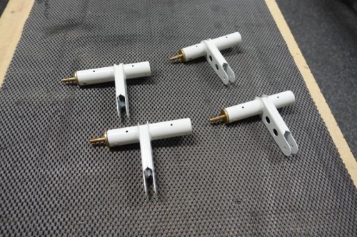

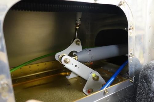

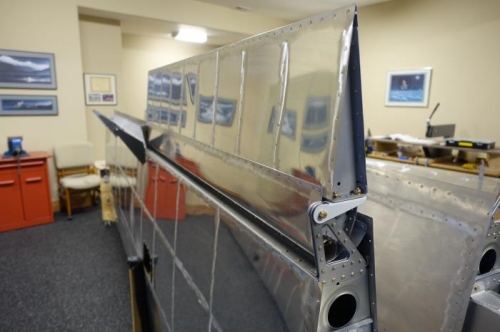

Assembled, drilled, primed and riveted the aileron torque tube sub assemblies. I'm unable to locate the WD-1014C torque tube. I'm actually a bit surprised more items haven't gone missing after storing the project for four years and then moving it halfway across the country. So, I've got that part on order. I moved ahead and started mounting the ailerons.
Aileron torque tube sub assemblies
Aileron bellcrank
Aileron bellcrank
Bottom of right aileron
