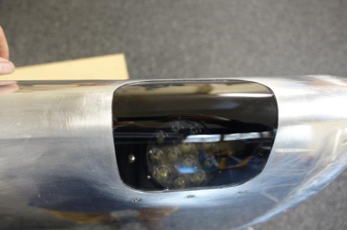

I finished the installation of the left landing light. I mounted the light bracket with LED landing light and did a final install of the light lens.

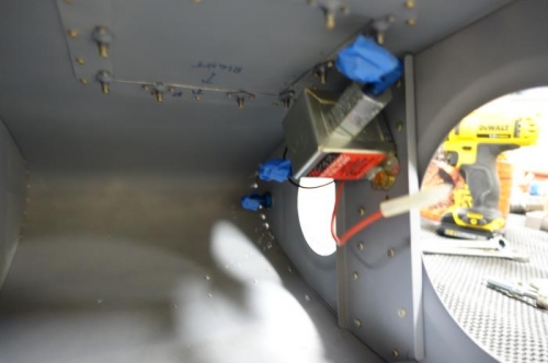

Installed the transfer pumps and associated brackets, fittings and some wiring.

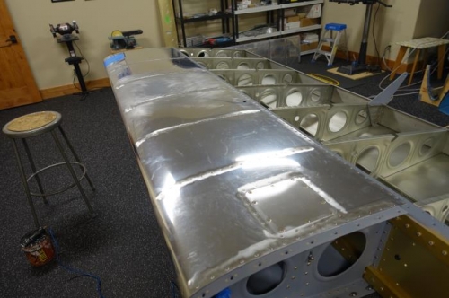

Installed the left leading edge to the wing spar. Riveted the leading edge ribs and the rear trailing edge skin. I need to build a mobile wing stand in order to easily store as well as access the upper skins for riveting.
Finished left landing light assembly
Left extended range tank transfer pump
Bottom of left wing/leading edge
