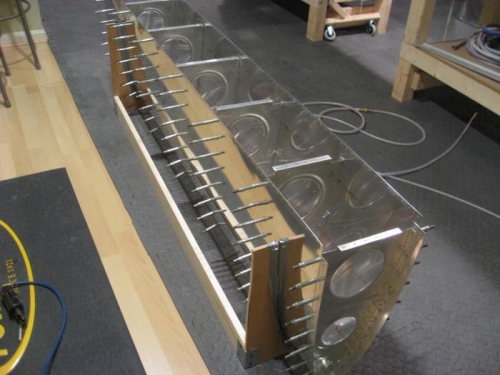

Date:  12-10-2013
Number of Hours:  5.20
Manual Reference:  17-2 & 3
Brief Description:  Leading Edge Assembly
An unplanned work day thanks to work closing due to a not too severe snow storm. I'm jumping ahead slightly since I'm having difficulty getting my riveting partner to help finish up the main top skins. Anyway, I finished deburring leading edge ribs. Fabricated the J-stiffeners, built the leading edge cradle assembly, prepared the splice strip and leading edge skins. Assembled the left skins to the ribs.
Left wing leading edge assembly
