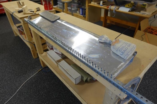

Finished riveting the right aileron skins. Glued,with proseal, the right trailing edges and attached it to a steel angle clamped to a work bench.

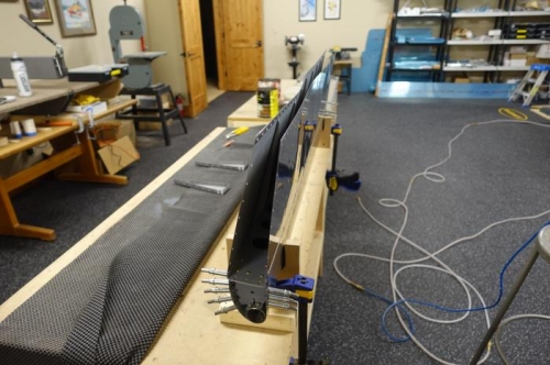

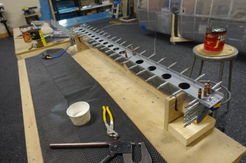

Continued work on the left aileron which included drilling out all holes to final size, dimpling/countersinking parts, priming,and assembling spar/leading edge. Riveted the top and bottom skins to the main spar.
Right aileron glued trailing edge
Left aileron leading edge assembly
Left aileron skins riveted to spar
