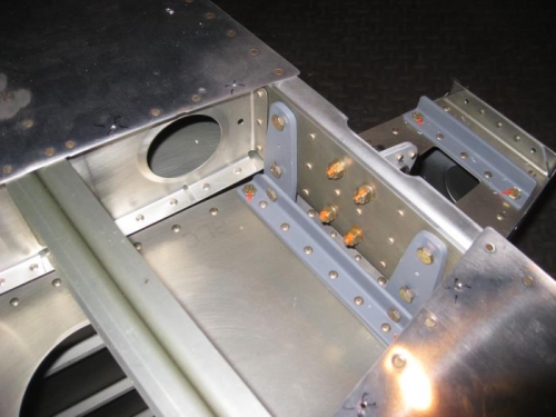

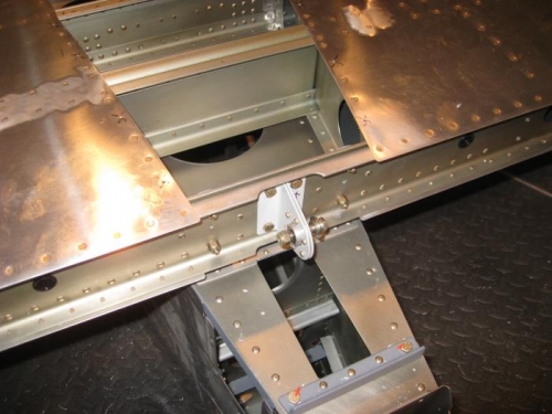

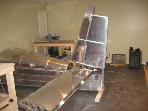

Continued mounting the elevators to the horizontal stabilizer. Final drilled the mounting and push-pull tube holes in the elevator control arms. Began mounting the horizontal stabilizer to the tail cone. Final drilled the four rear mounting holes of the horizontal stabilizer rear spar to the tail cone mounting brackets.
Horizontal stabilizer rear spar front view
