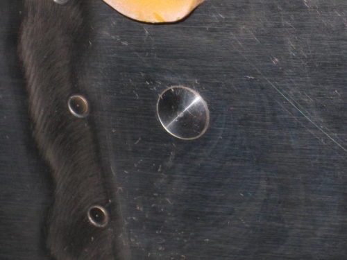

Installed and glued the tail cone static ports. I used the Cleveland ports and glued with Pro seal. Installed the numerous attachment bolts to the aft deck. Fabricated a wooden platform in order to access the interior to rivet the top skins.
Exterior view of the Cleveland static port

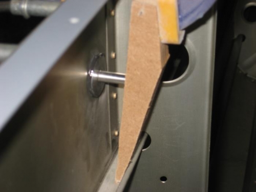

Interior view of the static port held in place with a clamp as the Pro seal dries

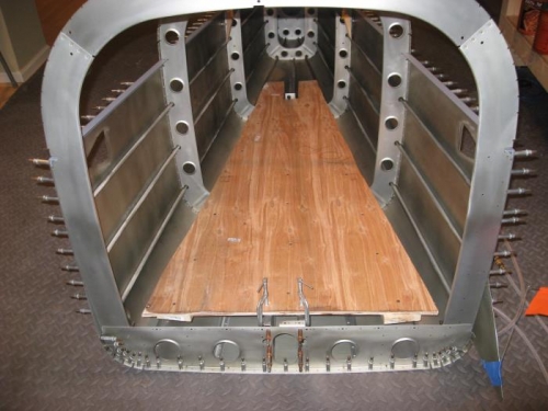

Wooden platform for interior access
