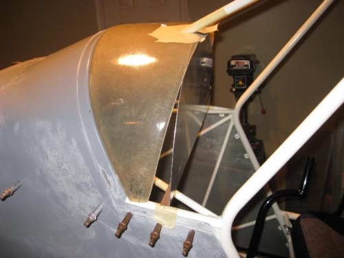

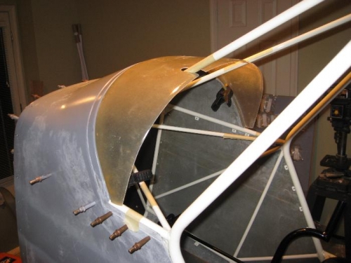

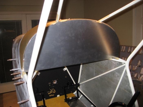

Installed the Joel Milloway vertical panel modification. It seems beneficial to get a little more tilt to the panel than provided with Joel's extension. Consequently, I'm going to pull the bottom of the panel out slightly which will require a modification to the extension. I chose not to move the top of the panel forward necessitating cutting the panel to accomodate the fuselage structure. More to follow.
Joel Milloway extension
Panel blank
Panel blank
Adjustment provides about six degrees of tilt.
