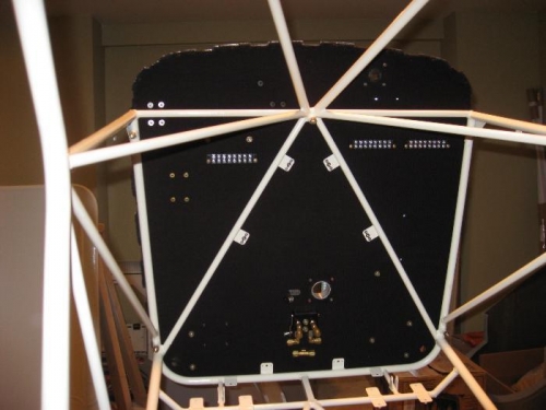

Continued to mount various items to the firewall to include parking brake, brake resevoir, oil bottle mounting bracket, coolant recovery bottle and rear engine mount. Mounted firewall assembly to fuselage.
Trimmed the boot cowl to the scribe line provided by Rans. The fiberglass is very thick in the lower corners adjacent to the firewall. I'll need to sand this area down a bit tomorrow to get the boot cowl all the way on.
Parking brake assembly is lower center

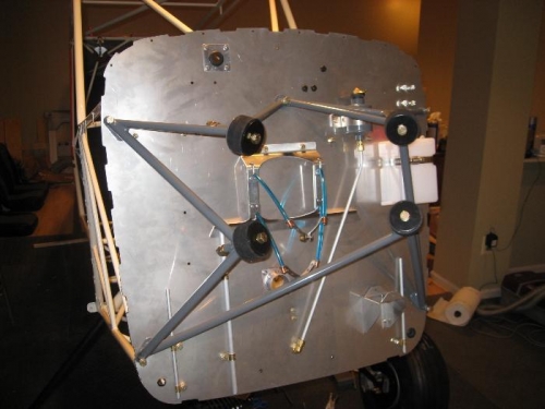

Oil bottle bracket is dead center.  Brake resevoir is the grey cylinder.

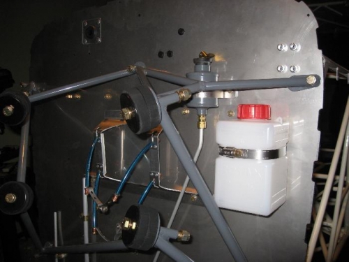

Better shot of resevoir and coolant recovery bottle.
