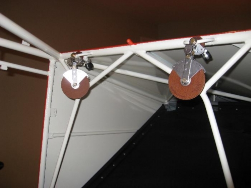

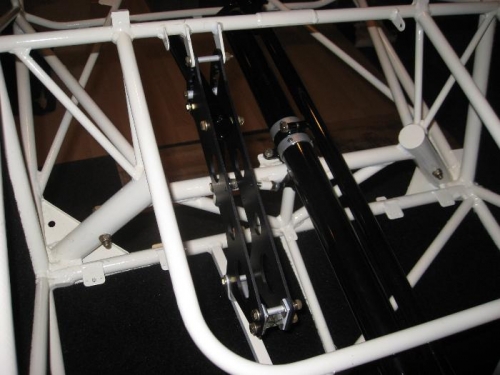

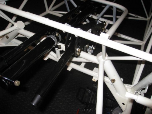

Installed aileron cable and pulley assemblies inside cockpit. Also installed flap handle mechanism. Assemblies go together without any issues. Take the time up front to organize all the parts bag on a board. It save considerable time looking for parts. It's also nice to have a 3/16" reem to run through the various holes that seem to get filled with paint, glue and such.
Aileron cable aft cockpit
flap handle looking aft
flap assembly looking forward
