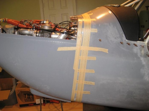

Brief Description:  Fit and installed cowl
Fit and trimmed top and bottom cowl. After multiple trimmings I drilled the two cowl halfs to the boot cowl. I mounted the cowl slightly low in anticipation of engine sag. I didn't mount the cowl too far in case the engine mount doesn't sag it will still look acceptable. The right outboard front of the cowl doesn't match up as well as I would like. Some additional fiberglas work is in order.
Bottom cowl taped in place.  Mount holes and trim lines are extended marked on boot cowl

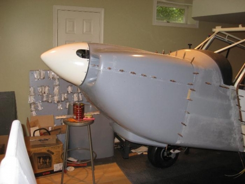

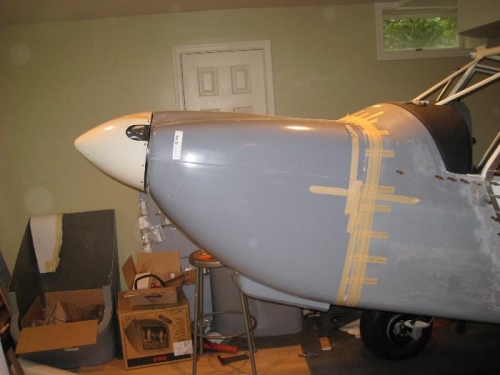

Top cowl in place
Top cowl in place
Top and bottom cowl drilled in place to boot cowl
