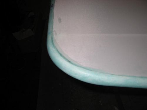

Finished gluing and ironing perimeter edges. As you glue the covering to the leading and trailing edges you invariably get a few bubles and wrinkles. You have to be careful shrinking the bubles with the iron because it can easily set a crease that is difficult to get out. I used a model airplane covering heat gun to shrink these bubles followed by the iron. The process worked exceptionally well.
Tip curve
Tip curve
