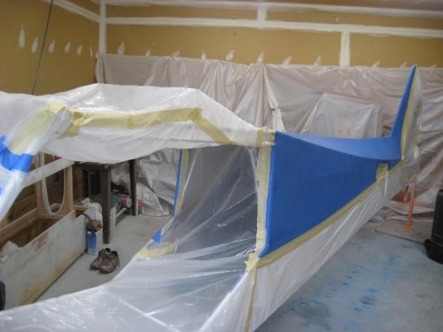

Every time I go out to the garage I see my painted fuselage. Unfortunately, I also see the debris that ended up in the final coat of the blue. I had great luck when I painted the white but for some reason both cross coats of blue ended up with debris. I thought it might be acceptable but the more I looked at it the more it irritated me. Then I saw where Mark Pensenstadler ripped off all the fabric on his S-6 because he wasn't happy with the results. Well, I figured if Mark can go to those lengths I can easily enough sand this last coat down and hit it one more time. I'm going to go over the paint booth with a fine tooth comb to try and remove as much dirt and debris as possible. I'm also going to put down new wall and floor plastic. Today I masked off the remainder of the fuselage and sanded the blue down with 400 grit wet.
