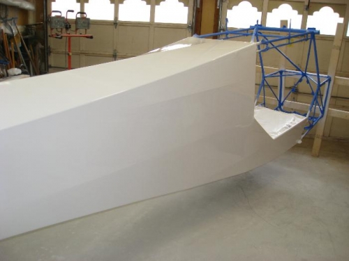

Brief Description:  Paint fuselage
Applied final white cross coat on fuselage. The application went exceptionally well. The only flaw is a small run at the top of the vertical stabilizer. I'm going to paint a blue sunburst pattern on the airplane and unfortunately, this area of the vertical stab remains white. However, once the blue is put down I can easily come back and mask off to repaint this much smaller area of white. At least that's my plan for now.
Run on top of vertical stab
