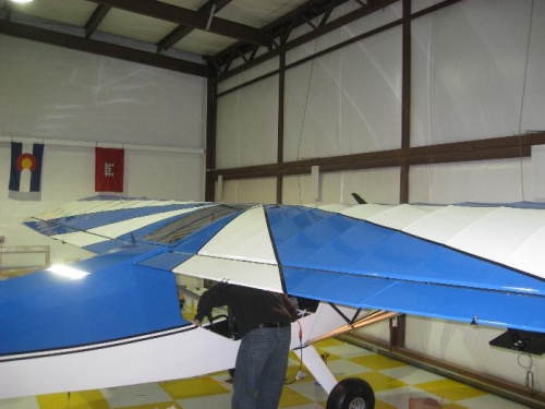

With the help again from Tom Chapman and Rob Brooks we continued on our quest to completion.
We finished all work on mounting, balancing and rigging the elevators, rudder, flaps and ailerons. Everything is in good order and operational per plans and specifications.
Finished routing of flap cables inside the fuselage.
Mounted the spinner.
Mounted a LED light in the baggage compartment.
Mounted the doors and began installation of the gas struts and associated brackets. Also, modified the baggage bulkhead closeout for the gas struct brackets and the flap cables.
Filled the engine cooling system with antifreeze.
Painted the inside of the cowl.
Continued fabrication of the fiberglass wing fairings.
Mounted wing tie down brackets.

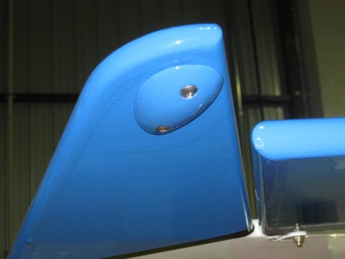

Elevator lead counterweight

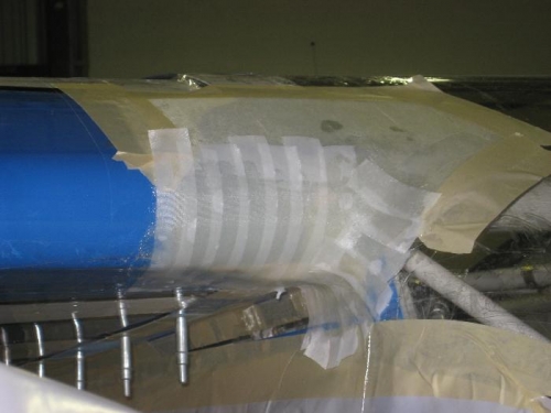

Fiberglass work on the wing fairing.
