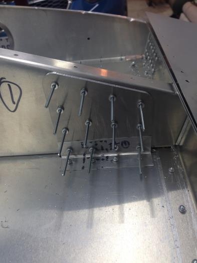

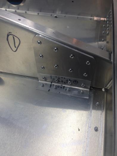

Removed A5 Rivits from Flaperon Bracket located on Rib #1. Reverse direction of Rivits and reinstalled. The rivits were causing interference issues with fuel tank installation.

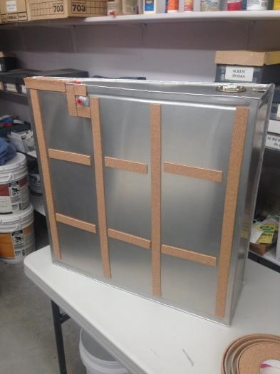

Installed the fuel tank sender unit.
Installed and fitted cork on fuel tank.
Left Wing Rib#1 Rivit Switch
Left Wing Fuel Tank
