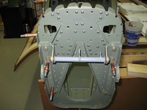

Brief Description: Bellcrank channel,push pull tube and trim tube
Installed trim torque tube, stab attach brackets and stinger brackets. Mocked up trim servo. Had to remove another .010 from the trim tube bushings face to get enough clearance from the tube flang and the bushing. Assembled and riveted bellcrank channel and push pull tube.
