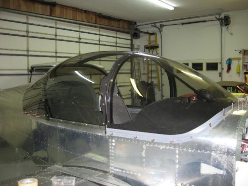

Trimmed and sanded the edges of the skirt and right side canopy glass. Shortened four aapq 62 rivets to attach canopy frame to the aircraft. Drilled to 30 and deburred skirt rivet holes then skirt to 28. Clecoed skirt in place. Installed right glass. If I ever have to replace the glass I now know how to do a better job but I think I still have enough wiggle room to get a nice even gap on the windshield.

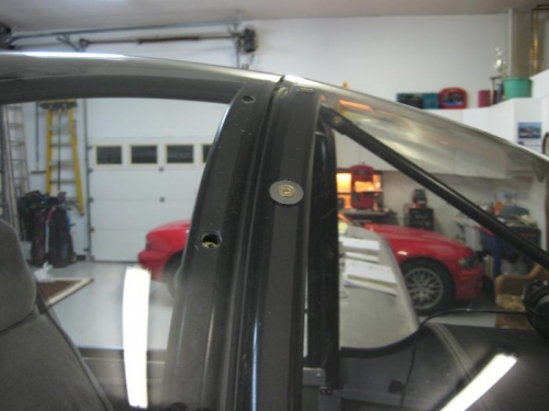

Not totally happy here yet
The gap at the bottom is a little wider but I think I can enlarge the holes a bit and make it even
