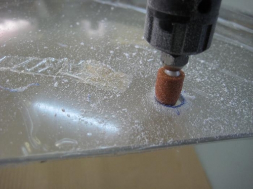

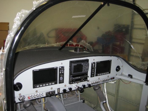

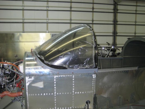

Removed rollbar I hope for the last time. Glued foam on to glareshield then glued fabric to foam. Cut opening for roll bar support and zaon acess hole. Reinstalled Rollbar. Placed windshield in place then trimmed fabric. Marked the holes in the windshield which moved some after installing the rivnuts. Used a grinding stone in a dremel to open up holes to 3/8. Installed the trim on the edge of glareshield.Placed foam on roll bar then placed windshield in place. The holes moved a little more with the foam in place but starting at the top and moving outwards the holes lined up as screws were tightend. Clecoed the hold down trim in place.
