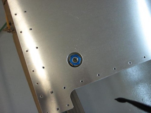

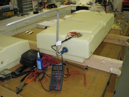

Used a plastic template to transfer the location of the fuel drain and vent then transfered them to the lower skin. Bent and cut fuel sending float wire to the size and angle I figured for the right tank. Modified the retaining bracket so I could get it into the tank. Cut holes in lower skin. Modified fuel pickup per manual. Installed fuel pickup,vent, drain and sending unit.l
Cut holes in tank bottom skin
Checking useable fuel and fuel sender
