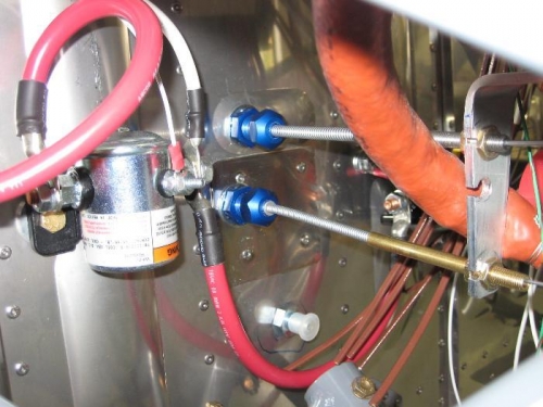

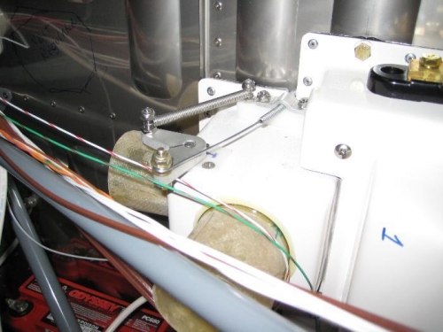

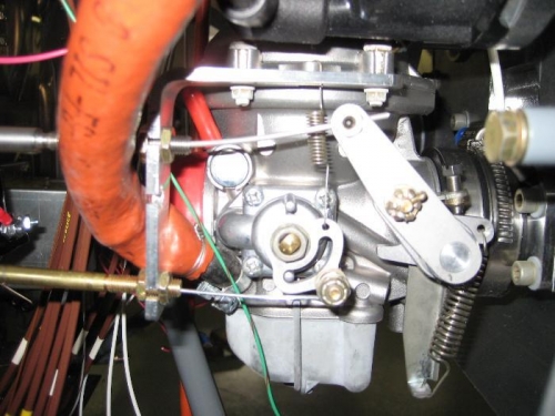

Fabricated a plate to block the hole in the firewall where the cabin heat goes on the rotax version, Located where the throttle and choke cables need to pass through firewall then drilled. Installed firewall grommets and secured cable. Fabricated a tool to roll wire then rolled the wire for the carb heat and choke and used a standard fastener for the throttle cable.
Cpver plate and throttle and choke pass through
Carb and choke cables
Carb heat cable
Carb heat cable
